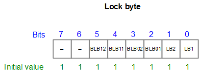

Fuse and lock bits are located on separate nonvolatile memory area. If wee look at Atmega328p microcontroller it has four bytes that needs to be written in order to configure MCU properly. One of those bytes contain lock-bits while other three fuse-bits. Fuse bytes are so called LOW, HIGH and EXTENDED. Each of them holds set of bits that sets initial MCU preferences like clock cycles, bootloader selection, etc. First of all lets see lock byte.
| Figure 1. | AVR Lock-bits. |
Depending on AVR type there can be different number of lock bits. But two least bits are always present. LB1 and LB2 bits are used to lock memory. You probably know that product developers practically always lock their microcontrollers to protect their intellectual property. So no one could read and duplicate. Reading locked chips is like a candy for hardware hackers, but this isn’t the topic for today. So unless you want to protect your firmware from copying you can lock the memory contents, otherwise leave lock bits as is. Other lock bit (BLB01, BLB02, BLB11 and BLB11) settings may be used to lock writing and reading to/from FLASH memory either from application area or bootloader section. These are also specific to application needs and we won’t be discussing them now. Usually you don’t change lock bits, but if you set any of those, lock bits are reset during chip erase.

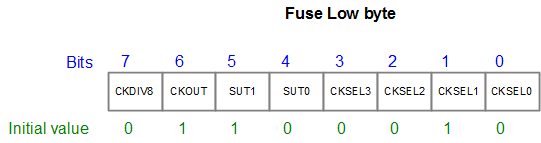

Lets looks at low byte of fuses. You can see a group of four similar bits CKSEL0..CKSEL3. They are used to select clocking options. By default CKSEL0..3 fuses are set to select internal 8MHz RC oscillator. This is logically safest option to start with. But as you know AVRs can be clocked in more different ways:
- Calibrated internal RC oscillator (default 8MHz);
- External RC oscillator;
- External crystal or crystal resonator;
- External low-frequency crystal;
- External clock signal source;
Each of selected clocking options have a range of CKSEL0..3 fuse bits settings that are used to narrow down frequency, start-up time from power down. CKSEL3..0 bits work closely with SUT0 and SUT1 bits that actually control start-up times. These are necessary to ensure enough time to stabilize ceramic resonators and crystals. You can find a detailed tables of exact timings on particular fuse selections.
Another fuse in the line is CKOPT. When it is programmed (0), oscillator swings at full rail-to-rail output. You can use this option when your device is in some sort industrial noisy environment to ensure normal operation. Also CKOPT is used when you want additionally drive another microcontroller from XTAL2 pin. Otherwise disable this option as it increases power consumption what is not welcome in battery driven projects.
Last bit in low fuse byte is CKDIV8. Device ships with this bit programmed (0) meaning that internal 8MHz RC clock is prescalled by factor 8. So by default system clock is 1MHz. If you need 8MHz system clock, then you need unprogramm this bit by writing 1 to it.

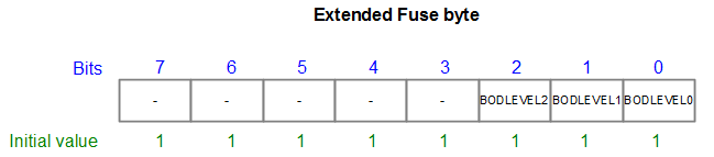

Last fuse byte is Extended. In Atmega328p we see three bits BODLEVEL0..BODLEVEL2. They select the brown-out voltage level when supply is no longer suitable for operation and device is reset.

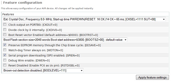

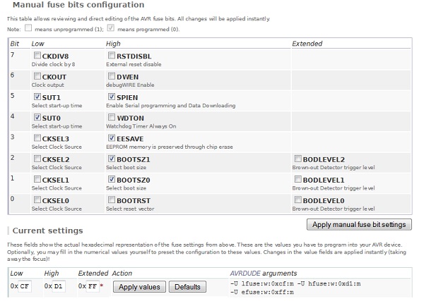

When you need to program new AVR chip you can pick up right fuse bits from datasheet. But there is more convenient and easy way by using AVR Fuse Calculator written by Mark Hammerling. In this web based fuse calculator you can select chip features and fuse bits are updated automatically (Figure 3).
| Figure 3. | Web based fuse calculator written by Mark Hammerling. |
Also you can set individual fuses in convenient form and low, high, extended byte values are updated automatically. Even AVRDUDE commands are produced:
| Figure 4. | You can set individual fuses in convenient form and low, high, extended byte values are updated automatically. |
