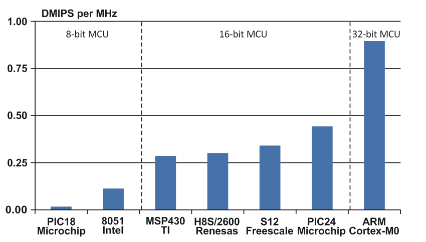

Figure 1. MCU performance comparison using the Dhrystone Benchmark.
Even the smallest 32-bit CPUs can do everything that 8-bit CPUs can do, and more, as Figure 1 shows:
  • More complex calculations. Examples include native-mode DSP, image processing, and gesture recognition
  • Data mining and analysis, and database lookup
  • Multitasking through a real-time operating system (RTOS)

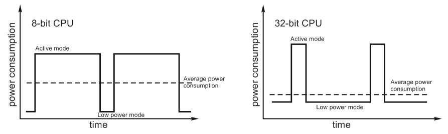

Consider a common low-power design where the CPU sleeps in a low-power mode and periodically wakes up to execute code in active mode (Figure 2). 32-bit CPUs may require more power than 8-bit CPUs in both modes, but they take less time to execute the code. As a result, the 32-bit CPU spends more time in the low-power mode. In many cases, this can result in advantageously reducing the average power.

Figure 2. Average power consumption comparison for computational intensive tasks.

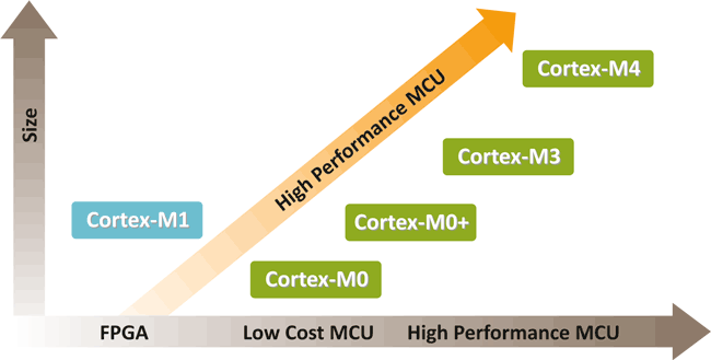

Today, most CPUs are marketed as a family of similar devices scaled from low- to high-performance. If your product needs to be scalable, then it makes sense your CPU should be scalable too. CPU scalability is usually defined in terms of:
  • Instruction set. Higher-end family members should have more instructions or more modes of operation for existing instructions, while maintaining backward compatibility with lower-end instructions.
  • Additional registers, or more bit definitions in existing registers
  • Additional functions, for example interrupt control and debug
The ARM Cortex-M processor family is a good example of CPU scalability, as Figure 3 shows.

Figure 3. ARM Cortex-M processor family overview.

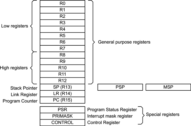

Figure 4. Cortex-M0 register architecture.
All registers are 32-bit, which enables 32-bit addressing and a 4-GByte address space. Most 8-bit CPUs are limited to a 64-Kbyte address space.
There are 12 general-purpose registers. (Low registers R0 – R7 have more support in the instruction set.) Special registers include:
  • dual stack pointers (R13) to help implement a real-time operating system (RTOS)
  • link register (R14) for fast return from function calls
  • program counter (R15)
  • program status register (PSR) contains instruction results such as zero and carry flags as well as the current exception number
  • interrupt mask register
  • control register controls which stack pointer is active

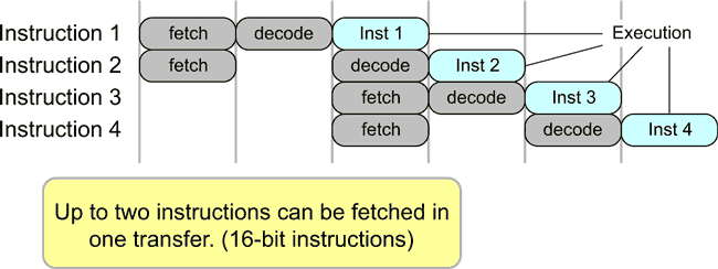

The ARM Cortex-M series CPUs have an instruction pipeline, as Figure 5 shows. This increases overall code execution speed because the CPU can execute one instruction while simultaneously fetching and decoding subsequent instructions.

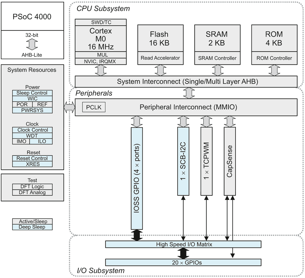

The PSoC 4000 is the entry-level member of the PSoC 4 family. In addition to the Cortex-M0 processor, it features a set of flexible and dynamically configurable peripherals, as Figure 6 shows.

Figure 6. PSoC 4000 block diagram.
This CPU also features capacitive touch sensing. Capacitive sensing touch offers significant advantages over mechanical buttons in terms of cost, performance, and ESD protection. CapSense features include:
  • Easy to implement buttons, sliders, and proximity sensing solutions, with up to 16 inputs routable to various I/O pins
  • High signal-to-noise ratio (SNR) ensures touch accuracy in noisy environments
  • Robust water tolerance for severe environments
  • SmartSense Auto-Tuning speeds time-to-market and eliminates the need for calibration
The CapSense block includes two DACs and a comparator, which you can use for other purposes if CapSense is not required.
