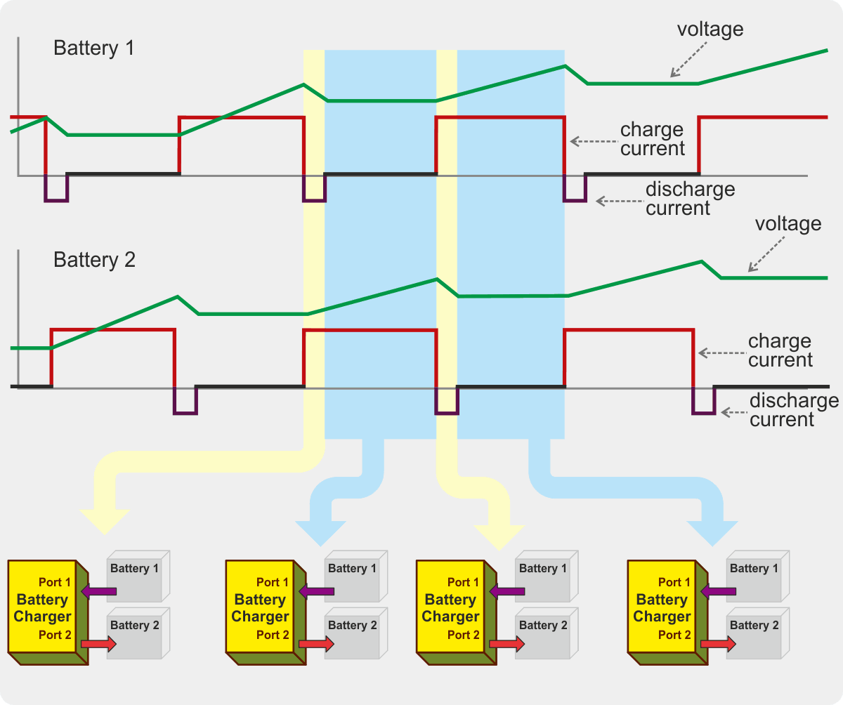

Concurrent charging
Josephs explains how this works:
The battery charger has two ports, one for each battery pack. Battery pack 1 and battery pack 2 are alternately charged and discharged. In the figure below, the battery voltage curve is depicted in green, the battery charging current is depicted in red and the battery discharge current is depicted in purple. See Figure 1.
A positive voltage slope (voltage increase) is generated during charge. A negative slope (voltage decrease) is generated during discharge. The flat area is the rest period of the charging cycle. The positive charging current amplitude can be three to four times the magnitude of a conventional charger due to our patented algorithm.
Charging batteries rapidly and safely
Figure 1. Battery pack 1 and battery pack 2 are alternately charged and discharged.
In the figure the battery voltage curve is depicted in green, the battery
is depicted in purple. (Image courtesy of Chargetek).
The industry standard charging current is based upon the amp hour (Ahr) rating of the battery and is denoted by C. For example, if each battery pack Is 500 Ahr, then the standard charge rate would be in the range of C/3 - C/5 resulting in a charging current range of 100 – 170 amps. There would be variations depending upon the characteristics of a particular battery.
For this particular application, the charge current would be set to 2C (1000 A) with a 50% duty cycle resulting in a charge rate of C or 500 amps. The discharge current would subtract from this slightly. The resulting charge time would be approximately 1.1 hours. This charge time is two to three times faster than what would be attainable using a conventional charger. With a conventional charger, the charge current would be limited to a maximum of C/3 or 170 amps.
The cost savings would be significant since there is only one charger required for two battery packs. In addition, at least twice as many battery packs could be charged in the same time. In summary, our charger has four times the charge capacity of a conventional charger.

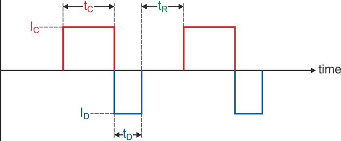

The algorithm
By reducing heat generating charge acceptance problems and electrochemical polarization, Chargetek’s algorithm is able to recharge at exceptionally high currents. See Figure 2.
Figure 2. Critical waveform parameters (Image courtesy of Chargetek).
Chargetek’s rapid charge technique is comprised of three fundamental components:
  1. Charge current pulse: The amplitude (IC) and duration (tC) is depicted in red. A charge current of two to three times the amp hour rating of the battery is typically employed.
  2. Discharge current pulse: The amplitude (ID) and duration (tD) is depicted in blue. The magnitude of this current is equal or greater to the magnitude of the charge current. The time duration is a fraction of the charging current.
  3. Rest time: The battery current is zero (tR).
During the entire charging process, battery temperature, rate of temperature change, battery voltage and current are continually monitored and modulated by the proprietary PDI
Chargetek software. The parameters of the algorithm are adjusted in real time during the charge.
