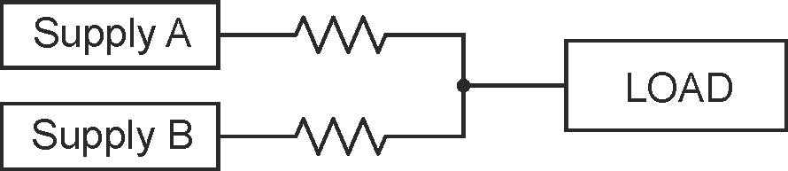

Another approach adds small ballast resistors in series with each supply’s output, to equalize the distribution of the load current among the supplies in the array even when their control loops are seeking dissimilar output voltages, as shown in Figure 1. The ballast resistors create some loss of load regulation, depending on the spread of setpoint errors that the ballasting intends to overcome. However, these ballast resistors also dissipate heat, which degrades system efficiency.
Paralleling power supplies: Many viable options, but know the tradeoffs
Figure 1. One sharing approach is to use relatively low-value ballast resistors on
each supply’s output, but this has issues due to resistor-related
dissipation and overall efficiency.

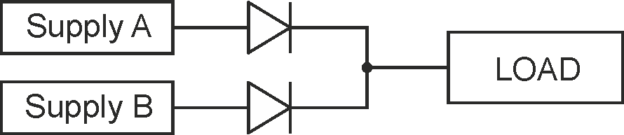

A seemingly "simple" solution to this direct-connect dilemma is to just use a diode between each supply and the common tie point of all supplies, a technique commonly referred to as diode-ORing, Figure 2. ORing diodes are very effective at preventing a supply from sinking current away from the shared output, but are generally insufficient to address sharing errors among supplies with independent error amplifiers, because the conduction knee is abrupt enough that parametric differences in the supplies’ setpoints will still lead to significant sharing imbalances.
Figure 2. In principle, multiple DC-supply outputs can be combined by using diodes
to isolate one supply from the other, but this configuration has many
performance issues related to balance and current sharing.
{from Vicor Back to Basics: What is Active ORing?}
Diode ORing is generally required for supplies acting independently, whose outputs can both sink and source current (two quadrant-operation). The effect of directly paralleling such supplies without ORing diodes is far worse than it is for single-quadrant supplies. While single-quadrant supplies will only suffer from load-sharing errors, two-quadrant supplies will actively contend for control of the common output voltage. This will cause current in excess of the load current to circulate among the supplies in the array, and likely lead to immediate overload of one or more of the supplies.
Also, if the diodes have a negative temperature coefficient for their conduction threshold, they will actually promote current hogging in the array. One way to minimize the problem is to use a method of rectification with a positive tempco – Schottky diodes, or via a diode-like function but built using FETs and a rectifier in an active-ORing implementation – but diodes can reduce efficiency due to forward voltage drop, and active-ORing can add cost and complexity.
Under some circumstances, diode ORing can still offer reliability improvements at the system level. The chief case of interest is where one of the supplies suffers a shorted output FET or capacitor which could jeopardize the common output voltage rail. ORing diodes will quickly decouple that short from the output bus, and improve reliability and system robustness.

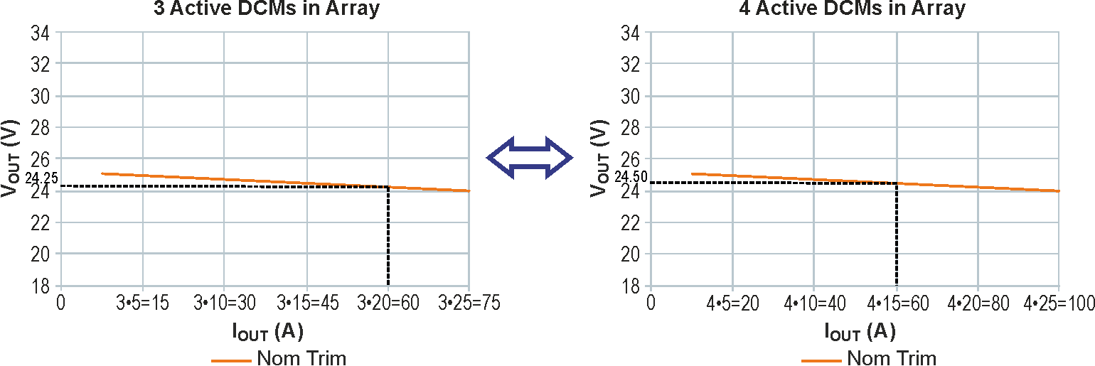

First, it’s a different way to implement a ballast resistor, and one which doesn’t involve wasted heat as there is no physical resistor and no V×I heat generated. A second difference relates to dynamic response, since for frequencies up to hundreds of kilohertz, a real resistor can be considered as having unlimited “bandwidth” in its I-V transfer-function curve due to lack of high-frequency parasitic concerns. As a result, any instantaneous change in voltage across the resistor results in an immediate corresponding change in current.
In the DCM converters, the load line is implemented through a discrete-time modulation of the digital/analog converter that creates the reference for the error amplifier. The correct reference value is calculated primarily based on an estimate of the DCM's output current, and involves some averaging to reduce noise. Therefore, the resistor that the DCM load-line emulates is one that acts like it has a significant capacitor in parallel with it, and the resulting RC-time constant is evident when looking at the datasheet figures which show the supply's response to a load step.
Nonetheless, having this load-line output characteristic permits multiple DCM outputs to be placed directly in parallel, while each still has its own error-amplifier control-loop still active. The distribution of the load current over the DCMs in the array is ideally equal if all DCMs have the same external (real) path resistances to the load, have the same trim setpoint, and are at the same temperature. Parallel DCMs thus behave like a single DCM but with a higher output current, Figure 4.
Figure 4. With the Vicor DCM converters, units connected in parallel perform as a
single converter; also, as the load-line shows, if the array is sized as N+1
redundant relative to the maximum load, the array continues to function
despite the failure of any single converter. {from Vicor Application
Note AN-030: Parallel DCMs, Figure 3}
With the DCM converter family, temperature changes in individual units are not a problem due to their negative voltage-temperature coefficient. If one supply is loaded more than the others, its temperature will rise relative to the others, which in turn will cause its output voltage to decrease. Since the output voltages of the other parallel DCMs match that of the loaded DCM, their outputs would follow their load lines, increasing their share of the load current and bringing the circuit back to equilibrium.
