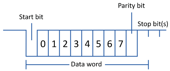

Most embedded engineers are familiar with a UART: a Universal Asynchronous Receiver/Transmitter. It is a microcontroller peripheral that converts incoming and outgoing bytes of data into a serial bit stream. A start bit initiates the serial bit stream and a stop bit (or two) completes the data word. A UART also has the option of adding a parity bit to the stream to assist in detecting if a bit error occurs during transmission. Figure 1 shows a standard example of what an engineer would expect to see from data transmitted through a UART.

USART vs UART: Know the difference - UART Serial Data
Figure 1. UART Serial Data.
