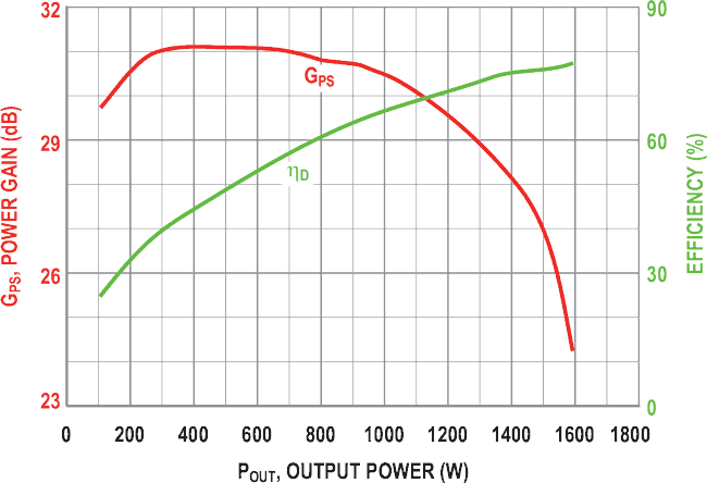

Figure 2. The MRF1K50H delivers 1550 W CW at 27 MHz with 25.9 dB
of gain and 78% efficiency.

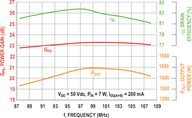

Figure 3. Key performance specifications for the MRF1K50H over the FM
broadcast band show 81 to 84% efficiency.

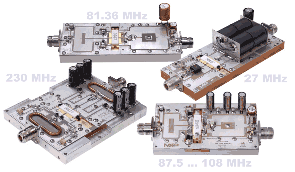

Figure 4. To help demonstrate the MRFK150 typical RF performance characteristics,
offers four reference circuits ranging from 27 MHz to 230 MHz.

Design resources are essential complements to the introduction of any new device, so NXP offers four reference circuits dedicated to frequencies at which the MRF1K50H will most frequently be used:
  • 27 MHz:
    This narrowband reference design is dedicated to the most common frequency employed in industrial applications such as heat sealing, drying, and welding.
  • 81.36 MHz:
    Manufacturers have settled on 81.36 MHz for excitation of CO2 lasers, for which the MRF1K50H is well-suited.
  • 87.5 to 108 MHz:
    FM and digital radio transmitters will benefit from the very high power of the MRF1K50H, as it can reduce the number of transistors and amplifier modules required to deliver a specific RF output power at the antenna terminals. This broadband reference design expressly serves the design of the systems.
  • 230 MHz:
    Narrowband aerospace and other applications operating at this frequency use pulsed rather than CW signals. This reference design is designed to accommodate applications with pulse rates of 100 μs at 20% duty cycle while delivering 1500 W of peak power.
