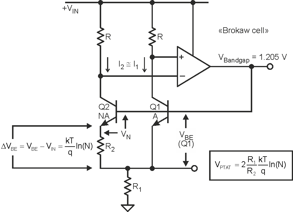

| Figure 1. | Bandgap and temperature sensor circuit based on ΔVBE. Courtesy of Analog Devices. | |
How the ΔVBE value is processed also varies. Figure 1 shows a simplified circuit that ADI has used to provide a 1.205-V bandgap voltage reference. The collector currents are forced to be equal by the op amp output that drives the transistor bases to a common voltage. This means that the current through R2 is equal to ΔVBE/R2. Therefore, the voltage across R is equal to 2× that current × R1 or
(2) |
where VPTAT is the voltage output proportional to absolute temperature.

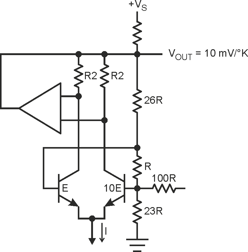

In contrast, Figure 2 shows an op amp used both to force equal transistor currents and to scale the output to 10 mV/°K. The 100-W resistor is used to add a second-order correction current.
| Figure 2. | Temperature sensor circuit based on ΔVBE. Courtesy of Texas Instruments. |
Note that in Figure 1, Q2 has the larger emitter area, but in Figure 2, Ql has the larger area. Nevertheless, both circuits leverage the difference of the base-emitter voltages. In Figure 1, ΔVBE appears directly across R2 between the two emitters, but in Figure 2, ΔVBE is measured across resistor R between the two bases.
In addition to developing a voltage or current directly proportional to temperature, some of these designs achieve a nominally zero-TC bandgap voltage reference output by adding VBE with a negative TC of about –2 mV/°C to ΔVBE with a positive TC of about +2 mV/°C. Bandgap circuits have an output voltage near 1.22 V – the bandgap voltage of silicon – and are used in designs for which the much higher voltage of a temperature-compensated zener is inappropriate.

The TI reference discusses higher accuracy linearization and conversion from a Kelvin to a Centigrade or Fahrenheit temperature scale output. Rather than the simplified relationship used in equation 1, a more complete V model, attributed to National Semiconductor's Robert Widlar, is given in Equation 3.
(3) |
The first two terms in the equation are linear, and the last two are nonlinear. Working with just the linear terms, it follows that
(4) |
where VG0 is the bandgap of silicon, typically 1.22 V; VE is the emitter voltage in Figure 2; and 273.7 is the Kelvin equivalent of 0 °C. During the derivation of this result, an equation was solved at T = 0 °C – the reason the 273.7 number appears. Nevertheless, as the TI reference states, "... the rate of change of VE with respect to temperature will be a constant, independent of the value of VB [the transistor's base voltage], the transistor's beta or VBE."
To complete the design, the two small nonlinear terms are approximated by a separate compensation circuit that provides a current proportional to the square of IPTAT a current proportional to absolute temperature. The LM35 sensor incorporates many of these ideas and features 10-mV/°C sensitivity and ±0.75 °C accuracy from –55 °C to +150 °C with no external adjustment required.
