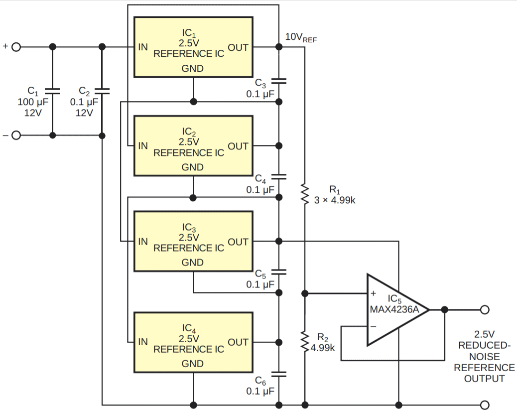

You can stack multiple voltage references in series to reduce their 1/f noise. The references' dc outputs add linearly, and their uncorrelated internal noise sources add geometrically. For example, consider a stack of four voltage references, each comprising a dc reference source, VREF, in series with a random-noise generator, VNOISE. Adding four reference sources produces the following outputs:
and
The original ratio of noise voltage to dc reference voltage thus divides in half.
Four 2.5 V references, IC1 through IC4, produce 10 V. Resistors R1 and R2 form a voltage divider that reduces the 10 V output to 2.5 V and lowers the output-noise voltage by half. Buffer amplifier IC5 isolates the reference circuit from the load.
Figure 1. Four 2.5 V references, IC1 through IC4, produce 10 V. Resistors R1 and R2 form a voltage divider
Figure 1 illustrates a method of adding multiple references to produce a single, less noisy reference voltage. The resistors are parts of a highly stable metal-film network, and buffer amplifier IC5 offers low noise, low input-offset voltage, and low offset-temperature coefficients.

Table 1 and Table 2 present the noise voltages that result from stacking four each of two types of 2.5 V references. Each table shows the 0.1- to 10-Hz noise voltage for each of the four references, IC1 through IC4, and for the combination. Note that the dispersion in the ratios of rms to peak-to-peak values relates to subjectivity in the method of measuring the values. In addition to lower 0.1- to 10-Hz noise, the circuit also reduces long-term drift of the reference voltage.
