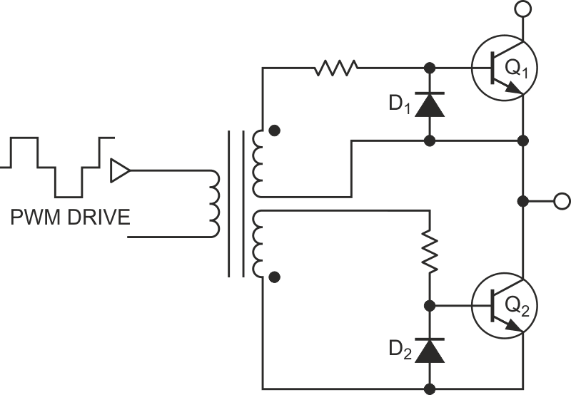

Most designers consider slowness in diodes to be an imperfection or a limitation. Why not take a more positive view of the situation? After all, a zener or an avalanche diode is no more than a diode with a limited breakdown voltage, and you can view a varactor as a diode with a large and nonlinear parasitic capacitance. Similarly, could you view the slowness of a diode as a property or even a feature? For example, consider a PIN diode. Few people are aware that the key property of a PIN diode is indeed its slowness; without it, it would generate large amounts of distortion and require a larger control current to function properly. You can put this ability of slow diodes to store large amounts of electrical charge to good use in a variety of other circuits. Figure 1 shows how to generate dead time using such diodes. A PWM sandcastle (stepped) waveform feeds a half-bridge.
You can use slow diodes to generate dead time in a half-bridge configuration.
Figure 1. You can use slow diodes to generate dead time in a half-bridge
configuration.
In a classical implementation, you must insert dead time in the control circuitry to avoid the simultaneous conduction of the two transistors when the duty cycle approaches 100%. This dead time is a standard feature of PWM-control ICs. If you use slow diodes for D1 and D2, you need no dead time. If, for example, Q1 receives a positive base, or gate, drive and is therefore conducting, D2 becomes forward-biased. When the control signal reverses its polarity, a negative bias appears immediately on Q1, but D2 cannot instantly cease conducting and short-circuits the base drive to Q2 during all of its reverse recovery time. The advantage of generating a dead time in this way lies in the fact that you need include only a small safety margin: The phenomena governing the recovery time of a diode are similar to those resulting in storage times in power devices. both display a strong positive-temperature coefficient, for which this scheme compensates. The ability to operate at duty cycles close to 100% allows a better usage of the power components, translating into savings and higher performance: A universal-input supply, for instance, can operate at lower supply voltages.
