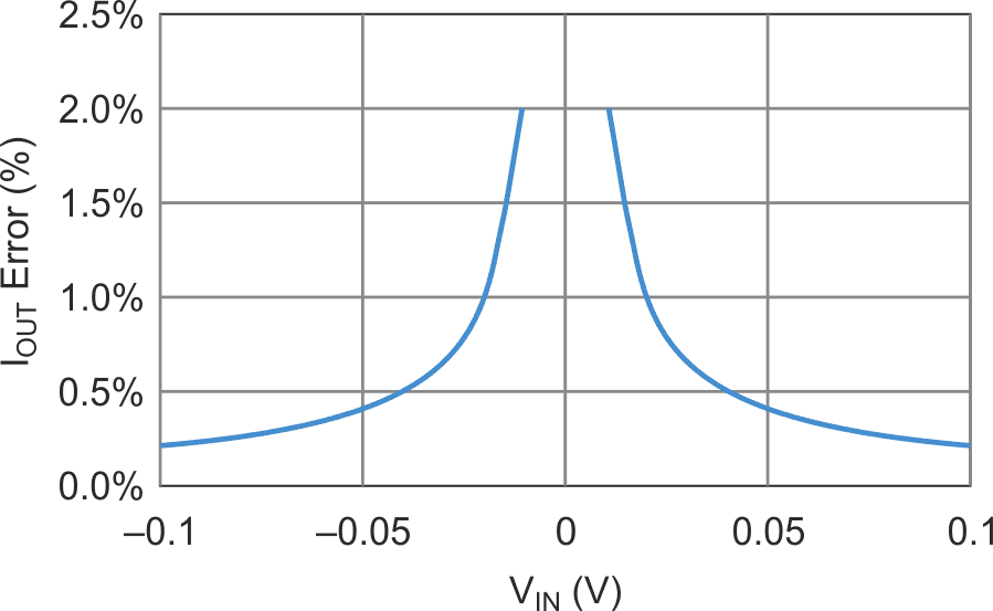

The accuracy test is a plot of output current error using a 0.1% resistor for. All testing was targeted at evaluating performance at up to ±10 mA output current. Figure 4 depicts output current error plotted against input voltage.
Output error of the circuit in Figure 3 plotted over a range of ±10 mA.
Figure 4. Output error of the circuit in Figure 3 plotted over a range of ±10 mA.

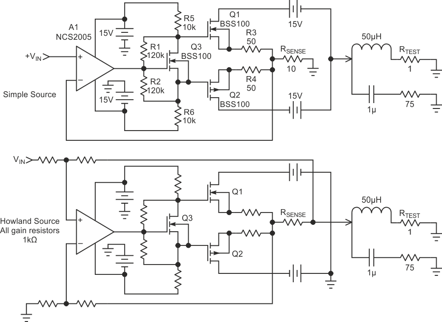

To show the benefit of this circuit when driving an inductive load it was compared to a Howland with both circuits driving a 50 µH inductor. The schematic in Figure 5 is included to show how the Simple Source was re-configured as a Howland current source. In each case the output current was observed across the 1 Ω non-inductive resistor in series with the 50 µH inductor.
Test circuits to compare dynamic response of Simple Source (top) vs. Howland (bottom). Output signal is observed across RTEST.
Figure 5. Test circuits to compare dynamic response of Simple Source (top) vs. Howland (bottom). Output signal is observed
across RTEST.
Both circuits required compensation networks across the inductor, but for different reasons. In the case of the Simple Source the output capacitance and load inductance need a snubber to control the ringing. The Howland also demonstrates ringing, much of which is caused by the inductor in the feedback loop. Using a square wave input, compensation was performed empirically. In each case start with a resistor across the inductor and reduce it until overshoot and ringing is smoothed out. Then introduce a capacitor and decrease value until overshoot and ringing start to show back up.
