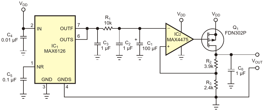

This low-dropout-voltage regulator features …
This low-dropout-voltage regulator features a noise floor of only 6 nV/√Hz, making it an ideal power source for low-noise oscillators

Ultra-Low-Noise Low-Dropout Regulator Achieves 6-nV/√Hz Noise Floor
Figure 1
20 Kb
Figure 1. This low-dropout-voltage regulator features a noise floor of only 6 nV/√Hz, making it an ideal power source for low-noise oscillators
