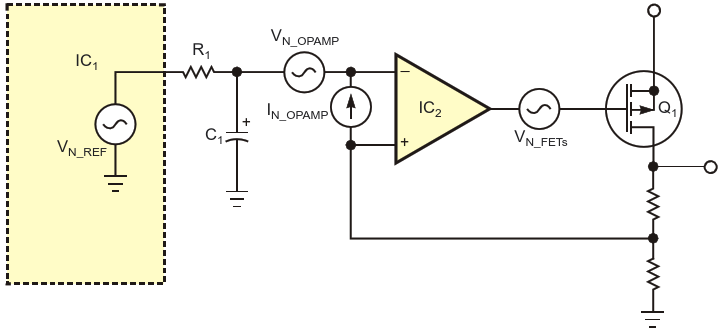

This simplified version of Figure 1 highlights noise sources for analysis

Ultra-Low-Noise Low-Dropout Regulator Achieves 6-nV/√Hz Noise Floor

Figure 1. This low-dropout-voltage regulator features a noise floor of only 6 nV/√Hz, making it an ideal power source for low-noise oscillators
Figure 2. This simplified version of Figure 1 highlights noise sources for analysis
Figure 3. A noise-density-versus-frequency plot for the lowdropout circuit in Figure 1 is 38 dB lower than that of a conventional low-noise, low-dropout-voltage regulator - in this case, a Maxim MAX8887
