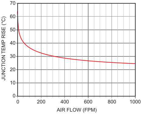

The TO-92 junction temperature …
The TO-92 junction temperature delta versus air speed at 320 mW showing the nonlinear relationship between airflow and sensor temperature

Nonlinearities of Darlington airflow sensor and VFC compensate each other
Figure 1. The TO-92 junction temperature delta versus air speed at 320 mW showing the nonlinear relationship between airflow and sensor temperature
