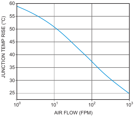

Nonlinearities of Darlington airflow sensor and VFC compensate each other
Figure 5
10 Kb
Figure 1. The TO-92 junction temperature delta versus air speed at 320 mW showing the nonlinear relationship between airflow and sensor temperature
Figure 2. The self-heated Darlington thermal airflow sensor
Figure 3. The nonlinear VFC is shown, with U1 configured in a 555 astable topology and a V
IN
resistor network, providing a solution for the previous nonlinearity
Figure 4. The linearized VFC airflow response (blue) where the increasing rate of Hz versus fpm cancels the nonlinear effects of King's Law to yield a 1 Hz = 1 fpm calibration
