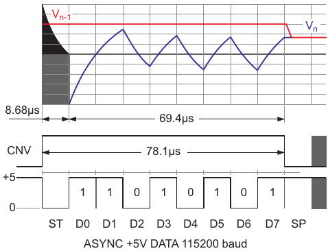

The SDD conversion cycle …
The SDD conversion cycle timing for 5 V logic levels

Figure 3. The SDD conversion cycle timing for 5 V logic levels
