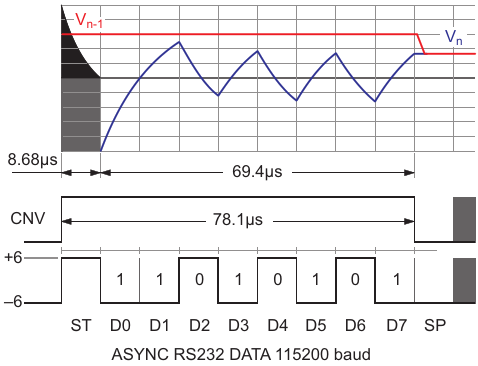

The SDD analog conversion from RS232 signal levels

Figure 5. The SDD analog conversion from RS232 signal levels
