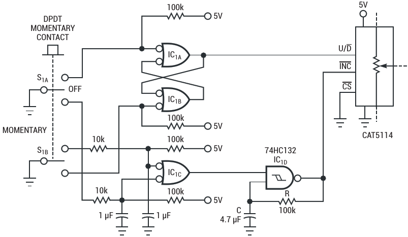

This is the original circuit, as published in Reference 1

Figure 1. This is the original circuit, as published in Reference 1
