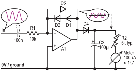

This basic peak log detector shows the principals involved and helps to highlight the problems. (Assume split, non-critical supply rails.)

Figure 1. This basic peak log detector shows the principals involved and helps to highlight the problems. (Assume split, non-critical supply rails.)
