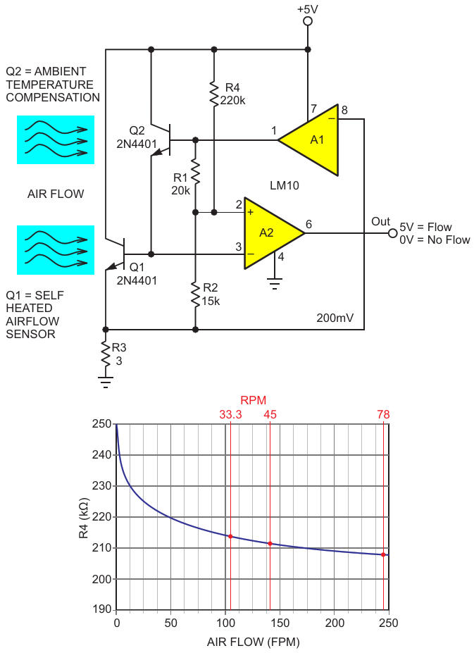

GO/NOGO thermal low speed …
GO/NOGO thermal low speed airflow sensor, ON/OFF airspeed threshold is set by R4

A groovy apparatus for calibrating miniature high sensitivity anemometers
Figure 1. GO/NOGO thermal low speed airflow sensor, ON/OFF airspeed threshold is set by R4
