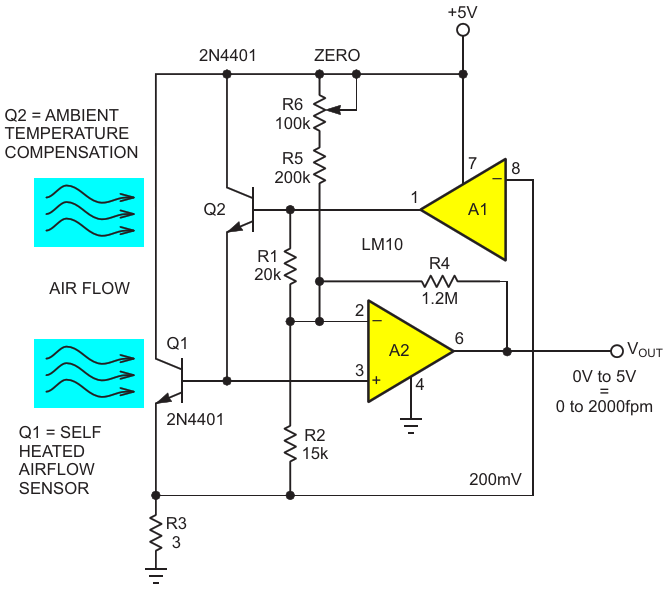

Improve thermal airflow sensor PSRR with just two resistors
Figure 1
16 Kb
Figure 1. Typical self-heated transistor thermal airflow sensor
Figure 2. Thermal sensor temperature versus air speed
Figure 3. Added R7 and R8 establish an instability-cancelling relationship between heating voltage V and heating current I
Figure 4. Sensor temperature versus supply voltage where: Blue = heating voltage V and (uncorrected) power; Red = heating current I; and Black = I×V = heating power / temperature
