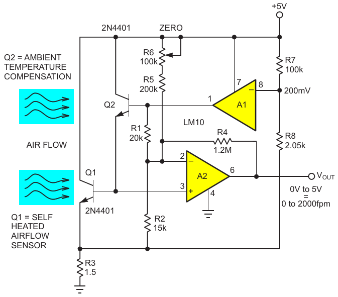

Added R7 and R8 …
Added R7 and R8 establish an instability-cancelling relationship between heating voltage V and heating current I

Figure 3. Added R7 and R8 establish an instability-cancelling relationship between heating voltage V and heating current I
