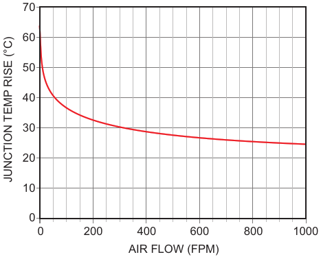

Figure 2. Thermal sensor temperature versus air speed
