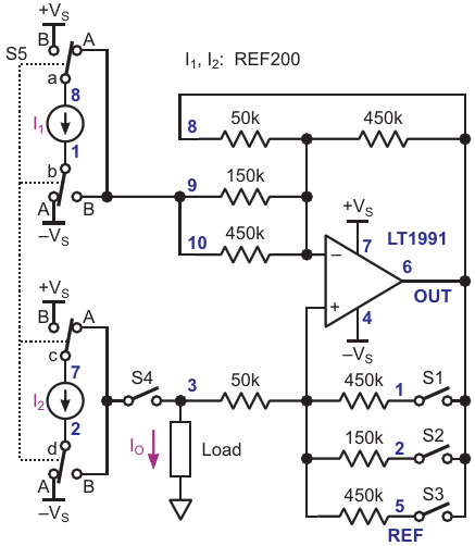

An LT1991 is used …
An LT1991 is used to source/sink from 10-90 µA in 10 µA steps

Precision programmable current source uses two ICs

Figure 4. An LT1991 is used to source/sink from 10-90 µA in 10 µA steps
