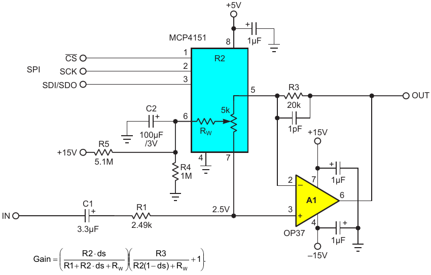

R2 has the same function as in Figure 1 with DC bias from R4R5C2 to accommodate bipolar signals. But what about R

Digital pot can control gain over a 90 dB span like an electromechanical

Figure 1. Grounded wiper makes R2 serve as both input attenuator and output gain set
Figure 2. R2 has the same function as in Figure 1 with DC bias from R4R5C2 to accommodate bipolar signals. But what about R
W
wiper resistance effects?
Figure 3. Positive and negative feedback loops around A2 combine to create active negative resistance = -R4
