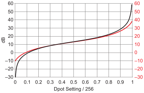

Red curve plots uncompensated RW (~150 Ω), note the 20 dB loss from both ends of the span. Black curve plots the case where RW is compensated with negative resistance (R4 = RW = 150)

Red curve plots uncompensated R sub W /sub  (~150 Ω), note the 20 dB loss from both ends of the span Black curve plots the case where R sub W /sub  is compensated with negative resistance (R4 = R sub W /sub  = 150)
