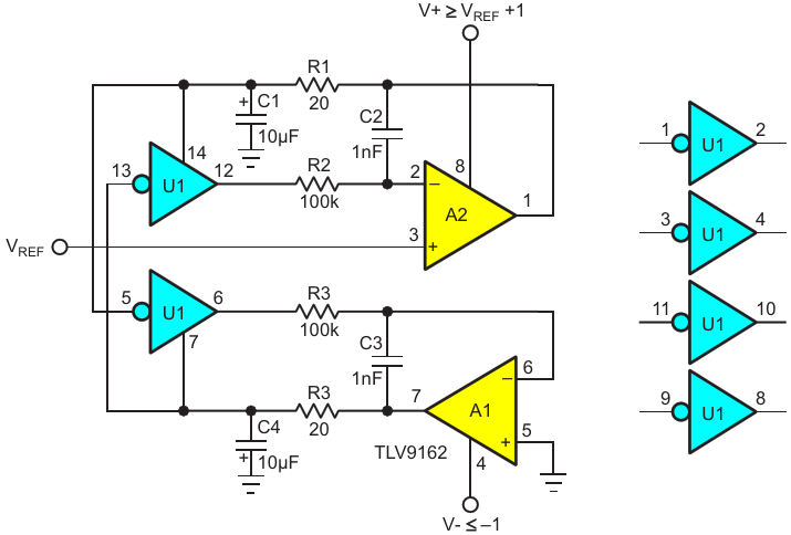

U1 is a multi-pole (e.g., 74AC04 hex inverter) PMW switch where op-amp A1 forces switch zero state to accurately track 0 = zero volts, op-amp A2 does the job for 1 = VDD
AuthorsStephen Woodward
Main DocumentArticle «Brute force mitigation of PWM VDD and ground "saturation" errors»
DescriptionFigure 1
File Format / SizePDF / 14 Kb
U1 is a multi-pole (e.g., 74AC04 hex inverter) PMW switch where op-amp A1 forces switch zero state to accurately track 0 = zero volts, op-amp A2 does the job for 1 = V sub DD /sub
