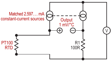

Using matched current sources in the bridge gives a linear relationship between temperature and output, and helps us define a reference point of 0 °C. Choosing the currents carefully gives a bridge output of 1 mV / °C

Using matched current sources in the bridge gives a linear relationship between temperature and output, and helps us define a reference point of 0 °C Choosing the currents carefully gives a bridge output of 1 mV / °C
