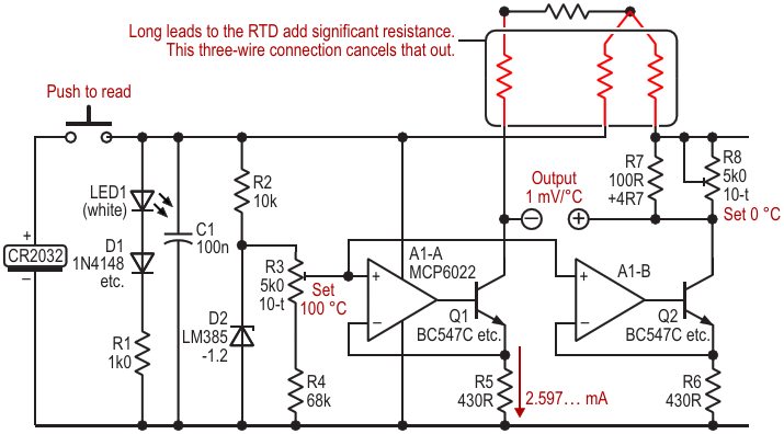

Figure 1. A bridge incorporating an RTD produces a voltage output related to the temperature, but usually with an offset 0 °C point
Figure 2. Using matched current sources in the bridge gives a linear relationship between temperature and output, and helps us define a reference point of 0 °C. Choosing the currents carefully gives a bridge output of 1 mV / °C
Figure 3. A practical circuit capable of delivering exactly 1 mV/°C
Figure 4. Three-wire connection to the RTD allows cancellation of the cable's resistance
