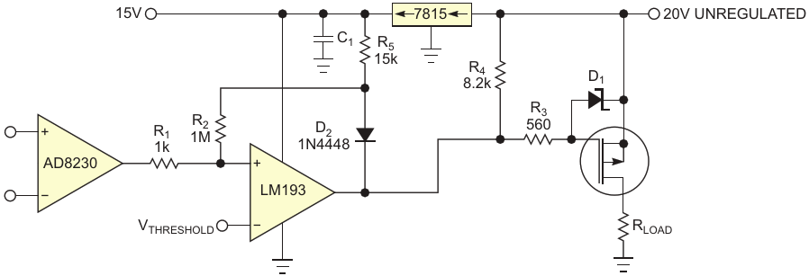

Resistor R5 and an ORing diode isolate the hysteresis circuit from the power supply and keep the switching point constant no matter how the power supply changes

Resistor R sub 5  /sub and an ORing diode isolate the hysteresis circuit from the power supply and keep the switching point constant no matter how the power supply changes
