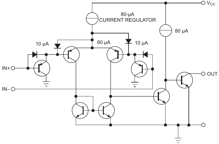

The internal design of the LM193 comparator requires that you keep the input pins 2 V below the positive rail

tie to the unregulated supply, causing the comparator's switching point to vary with the power supply
Figure 2. Resistor R
5
and an ORing diode isolate the hysteresis circuit from the power supply and keep the switching point constant no matter how the power supply changes
Figure 3. The internal design of the LM193 comparator requires that you keep the input pins 2 V below the positive rail
