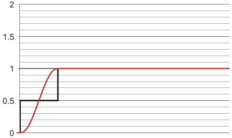

Half &Half drive step …
Half &Half drive step with half amplitude and half resonance period kills overshoot and ringing

Figure 2. Half &Half drive step with half amplitude and half resonance period kills overshoot and ringing
