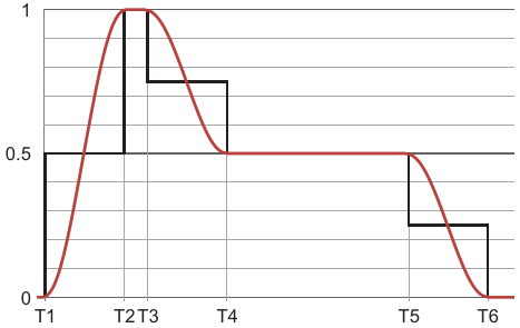

Example of three arbitrary …
Example of three arbitrary H&H moves: (T2 - T1) = (T4 - T3) = (T6 - T5) = ½ piezo resonance period

Half & Half piezo drive algorithm tames overshoot and ringing
Figure 1. Typical piezo actuator response to squarewave drive with ringing and ~100% overshoot
Figure 2. Half &Half drive step with half amplitude and half resonance period kills overshoot and ringing
Figure 3. Example of three arbitrary H&H moves: (T2 - T1) = (T4 - T3) = (T6 - T5) = ½ piezo resonance period
