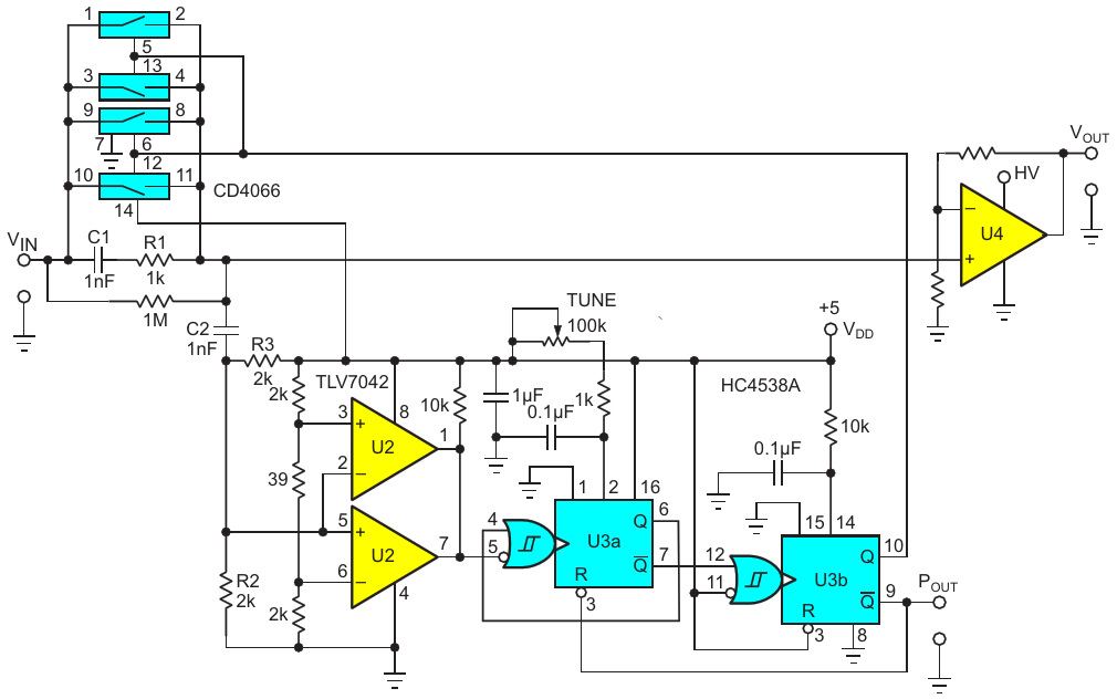

Figure 3. Example of three arbitrary H&H moves: (T2 - T1) = (T4 - T3) = (T6 - T5) = ½ piezo resonance period
Figure 4. The analog implementation of H&H
