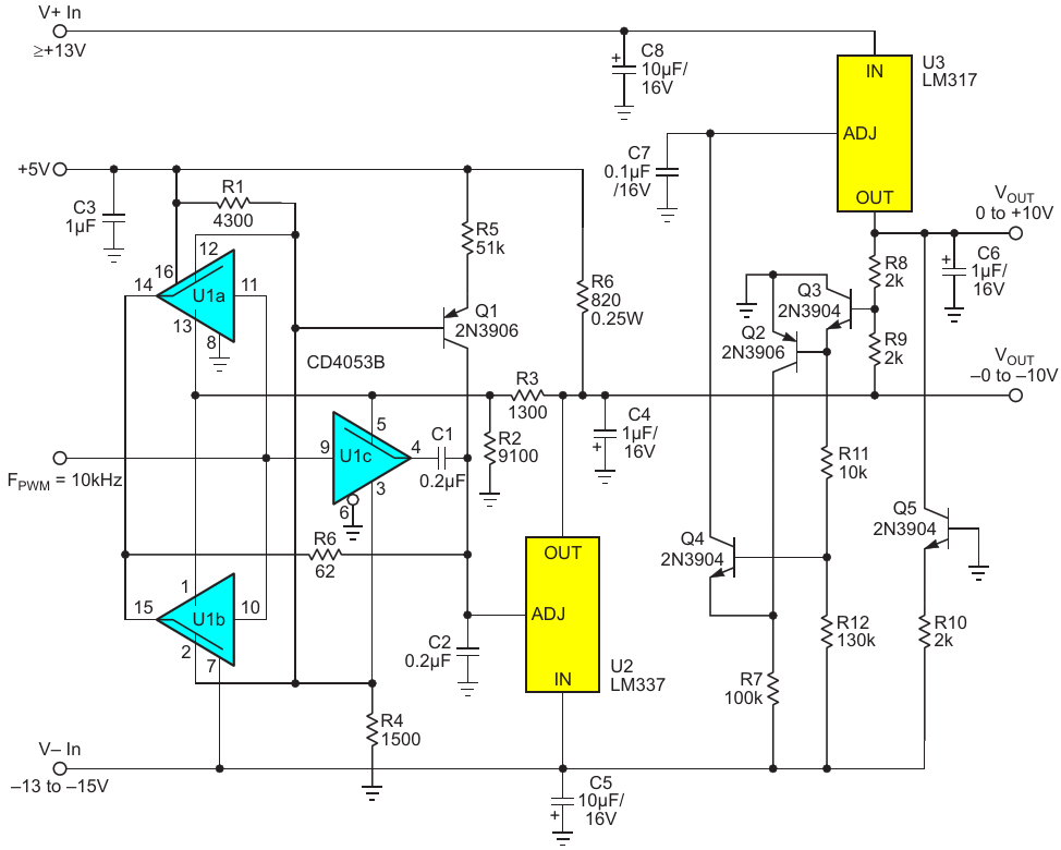

LM337, LM317, and CD4053 join forces in a symmetrical 0 to ±10 V PWM programmed power supply.
Stephen Woodward
Symmetrical 10 V, 1.5 A PWM-programmed power supply
Figure 1. LM337, LM317, and CD4053 join forces in a symmetrical 0 to ±10 V PWM programmed power supply.
Figure 2. V
OUT
(0 to -10 V and +10 V) versus PWM duty factor, D (0 to 1). The black curve is LM317's V
OUT
= 1.25 D/(1 - 0.875 D). The red curve is LM337's V
OUT
= -1.25 D/(1 - 0.875 D)
Figure 3. The PWM D required for any desired V
OUT
. PWM D = |V
OUT
|/(0.875 |V
OUT
| + 1.25)
Figure 4. D (x-axis) versus V
OUT
(y-axis) is (fairly) close to a logarithmic function, which makes good use of limited 8-bit PWM resolution
