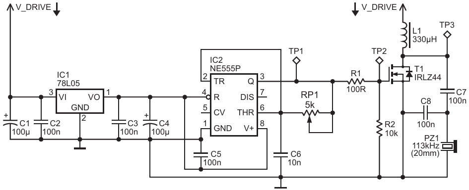

The circuit diagram of …
The circuit diagram of the final part of the project - the transducer driver

Ultrasonic mist maker (DIY)
Figure 2. The circuit diagram of the final part of the project - the transducer driver
