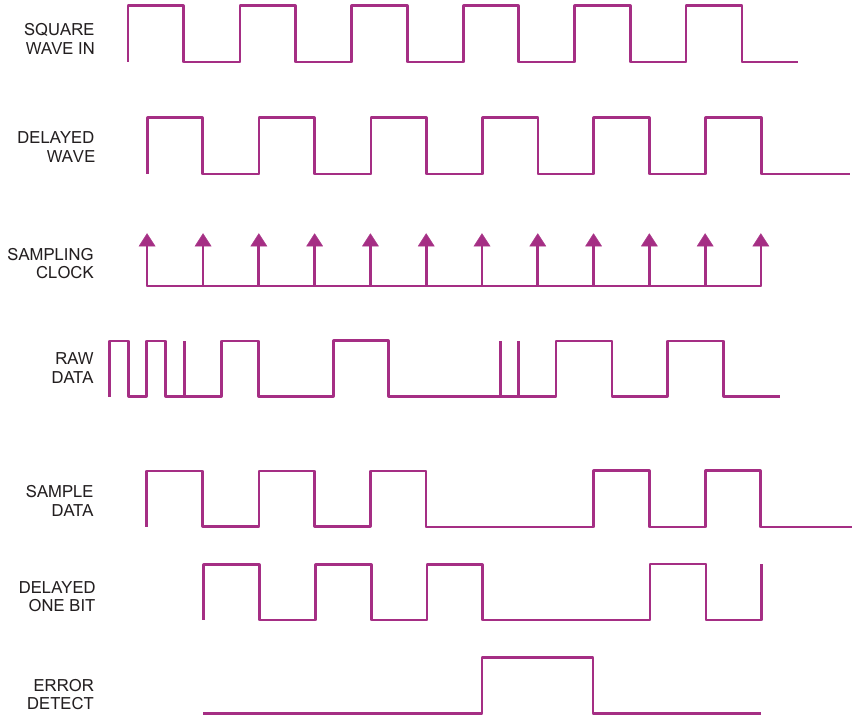

This timing diagram illustrates …
This timing diagram illustrates the operating principles of a simple BER tester

Figure 1. This timing diagram illustrates the operating principles of a simple BER tester
Figure 2. The BER tester uses a signal generator with OOK (on/off-key) modulation
Figure 3. The simple BER tester uses an adjustable phase shifter and a differentiator
