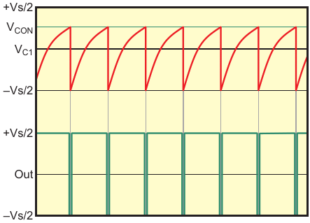

The VCO waveforms; reset …
The VCO waveforms; reset pulses at the end of each timing cycle, and is triggered when V
C1
= V
CON
, to force an adequately complete discharge of C1

Figure 2. The VCO waveforms; reset pulses at the end of each timing cycle, and is triggered when V
C1
= V
CON
