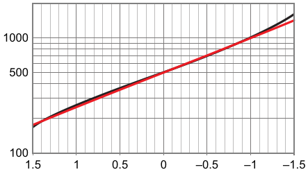

The effect of the …
The effect of the R4 modification showing a linearity improvement. [X axis = V

Figure 4. R4 sums ~6% of V
CON
with the C1 timing ramp to get the improvement in linearity shown in Figure 5
Figure 5. The effect of the R4 modification showing a linearity improvement. [X axis = V
CON
volts (inverted), Y axis = Hz/16]
