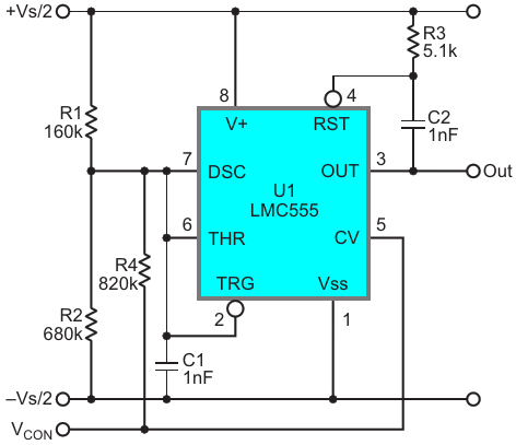

Can a free running LMC555 VCO discharge its timing cap to zero?
Figure 1. 555 VCO discharges timing cap C1 completely to the negative rail via a Reset pulse
Figure 2. The VCO waveforms; reset pulses at the end of each timing cycle, and is triggered when V
C1
= V
CON
, to force an adequately complete discharge of C1

Figure 4. R4 sums ~6% of V
CON
with the C1 timing ramp to get the improvement in linearity shown in Figure 5
