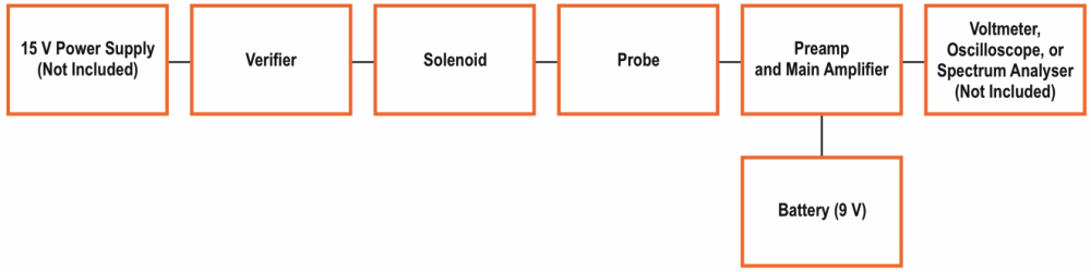

To begin, we will need two simple analog instruments:
  • A hand-held magnetic field meter with a field sensor probe
  • A calibration reference verifier source capable of producing a magnetic field strength of up to 1000 A/m (amps per meter) or 1.26 mT
Generally, high-accuracy measurements are unlikely to be practicable or useful. This is because many magnetic field strengths, particularly at high frequencies, can vary considerably even over short periods and distances. In addition, it's important to note that the verifier overcomes a requirement for the instrument to have high intrinsic accuracy, but its stability is normally more than adequate.
A hand-held unit for measuring magnetic field strength
Let's dive into the development and components of the hand-held magnetic field strength unit. To begin with, let's look at a block diagram of the meter and verifier shown in Figure 1.
Block diagram of the magnetic field meter and verifier.
Figure 1. Block diagram of the magnetic field meter and verifier.
Note that the meter is powered by a single 9 V battery. From here, we'll break down the different necessary components.

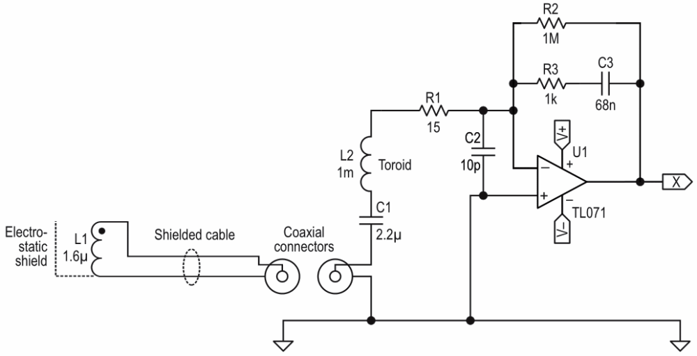

Magnetic field probe and preamp
The probe consists of a 1.6 μH inductor that is 8 mm long and 7.5 mm in diameter. It is wound on an insulating former and has about 22 turns. An electrostatic shield (a single overlapped, insulated turn of copper foil) is provided. Regarding frequency response, the inductance value is not critical, but the physical dimensions affect the sensitivity. The probe is connected to a coaxial cable with the electrostatic shield connected to the cable shield.
The probe is directional, and normally it is placed with its axis vertical (assuming a horizontal cable) and senses the vertical component of the magnetic field. Still, the user can set it horizontally to measure the horizontal component.
Overall, the total field strength at a point is the square root of the sum of the squares of the vertical field, HV, and the two components of the horizontal field, HX and HY.
The schematic of the probe and preamp is shown in Figure 2.
Probe and preamp schematic.
Figure 2. Probe and preamp schematic.
The preamp is physically integrated with the main amplifier and shares a common ground. The output, X, from the preamp connects to the input, X, of the main amplifier schematic shown below in Figure 3.
Main amplifier schematic.
Figure 3. Main amplifier schematic.
The preamp consists of a transconductance amplifier with a very low input impedance. This technique produces a flat frequency response from a mutual-inductance source. However, it can be impractical to obtain a low enough input impedance compared with the reactance of 1.6 μH at 20 Hz. One way to overcome this is to increase the inductance by a series 1 mH toroidal inductor insensitive to external magnetic fields. The resistance of the coil and the added 15 Ω resistor is compensated by including a capacitor in series with the 1 kΩ feedback resistor.
This inductor consists of about 20 turns on a ferrite toroid, 9.6 mm outside diameter, 4.7 mm inside diameter, and 3.2 mm thick. The Digi-Key part number of the toroid is 240-2522-ND. Commercially available 1 mH inductors are physically large parts designed to carry large currents and are unsuitable here.
