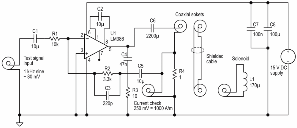

A simple way of producing a large magnetic field strength is to use a solenoid. The field strength and inductance can be calculated accurately from the physical dimensions and the current. The measured value of the inductance acts as a check on the calculated field strength.
The solenoid is 50 mm long, 16 mm in diameter, and has 200 turns. It is wound on a cardboard former (which will not melt if touched by a soldering iron). The former bore needs to be large enough to accommodate the probe, of course. It can be fitted with a phono connector glued in at one end (hence the need for soldering), so that it can be connected by a shielded cable to the verifier amplifier.
The verifier amplifier is a low-power amplifier using an LM386 operating from a 15 V supply. It is configured as a current-source output to produce a substantially constant current at any frequency from 20 Hz to 100 kHz, with a limited reduction up to 150 kHz.
The verifier schematic is shown in Figure 6.
Figure 6. | Schematic of the verifier and solenoid. |

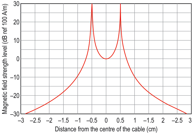

Magnetic field leakage from a flat cable (like Romex)
At a distance from the cable, compared with the spacing of the two current-carrying conductors, the magnetic fields from the opposing currents nearly cancel, but close to the cable, they do not. The field strength can be accurately calculated. Figure 10 shows the result of a simplified calculation of the vertical component of the field produced by two conductors 1 cm apart, with the conductors assumed extremely thin. It can be seen that the field strength falls off very rapidly with distance but can be quite strong close to the cable.
Figure 10. | Vertical magnetic field strength between and beyond the very thin conductors of a horizontal two-conductor cable 1 cm apart. |
