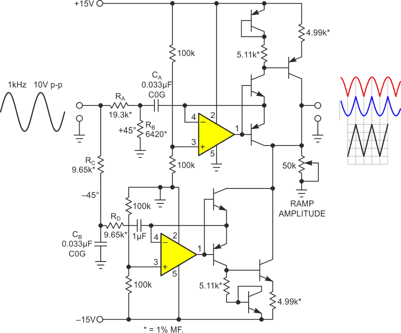

For an example of the utility of a current mode output, see Figure 3.
Current mode outputs can be easily summed up to produce a new function.
Figure 3. Current mode outputs can be easily summed up to produce a new function.
Here an incoming 1 kHz sine is split and phase shifted into two quadrature components by simple RC networks prior to rectification. A +45° phase-lead shift is provided by the RA, RB, CA in the positive-signal path, while a –45° phase lag is introduced into the negative-signal path by RC, RD, and CB. This results in a net 90° quadrature relationship between the two opposite polarity signal pathways.
When the full-wave rectified quadrature signals are summed, the result is an approximate (roughly ±3% nonlinearity) triangular waveshape at double the frequency of the sine, with amplitude proportional to the sine’s.
Adjustment of the quasi-triangle’s amplitude is accommodated with a simple variable resistor.
