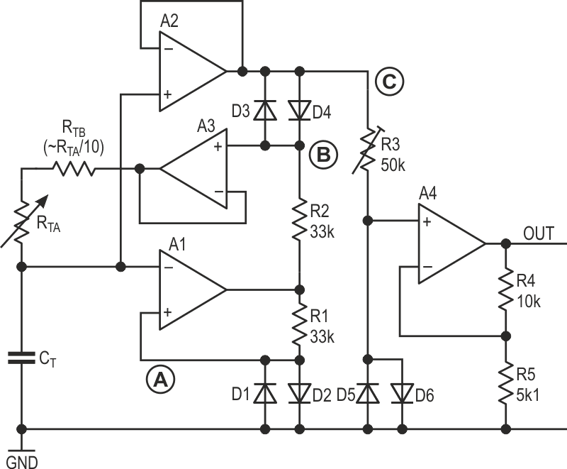

A different approach was needed, and Figure 2 shows the core of the new circuit. (Assume balanced ± supply rails.) I had wondered if the best level for the tri-wave might be exactly one diode-drop each way, and if we could define everything in terms of a diode’s forward voltage (VF): that was the germ of the idea, and now of this DI.
Simple, novel tri-wave generator and sine converter.
Figure 2. Simple, novel tri-wave generator and sine converter.
In effectively combining the generation of the tri-wave with its conversion to a sine wave, first-order errors could be eliminated, so minimizing frequency changes with supply voltage and temperature, and allowed final trimming to between 0.7 and 3% THD depending on the frequency. There are other ways of arranging the same elements to get the same results, but this one minimizes delays and so works better. We’ll be improving it further, later.
First, we replace RF2 with a pair of diodes, D1 and D2, so that the trip points are defined by their VFs, the voltage on CT now swinging by ±VF. Next, we add bootstrapping to linearize the waveform. (This DI (Ref. 4) shows another application of this technique.) RT is driven by a buffered copy of CT’s voltage plus/minus the voltage across D3/4, so the voltage across it is always 2VF, giving linear ramps. Thus, CT’s voltage and hence A2’s output is a clean triangle wave with a peak-to-peak amplitude of 2VF. Supply variations are largely absorbed in R1 and R2 – not fully, but we can ignore this as being a second-order effect; oscillation frequency is within 1% from 3 to 15 V across the rails. A3 buffers the feed to RT so that R2 and D3/4 remain unloaded. Figure 3 shows the waveforms for the circuit and the FFT of the output with R3 critically adjusted at ~1 kHz.

Diodes are inherently temperature-sensitive, their forward voltage dropping by about 2 mV/°C. Thus, the trip points change by this amount, potentially leading to an increase in operating frequency with temperature. However, the voltages across D3/4 fall by the same amount, reducing the drive to RT in proportion, thus canceling out variations due to temperature changes. We now have an excellent, symmetrical tri-wave with a defined amplitude of 2VF pk-pk and frequency-stabilized against variations in temperature and supply voltage.
Feeding it through R3 into D5/6 squashes it into a reasonable sine wave, thanks to the diodes’ log relationship between current and voltage (but see this Wikipedia article (Ref. 3) again). D5/6’s VF falls with temperature, but so does the triangle’s amplitude. A4 amplifies the sine wave to give an output level of about 2.2 V pk-pk – 0.775 V RMS, or 0 dBu. (Not shown is the range switching of CT, output level control pot, gain-of-3 output amplifier.) R3 is trimmed for minimum third-harmonic content using a scope’s FFT; around 20k is the best compromise value.
However, on setting set this up at, say, 1 kHz, distortion is much worse at other frequencies, especially beyond 8 kHz. This is due to A1’s performance, and we’ll look at this later. But while the third harmonic is the one we are concentrating on, what of the others? A simple twin-tee notch filter with feedback, built for close to 1 kHz with a Q of 2 and a gain of 10, allowed the scope’s rather basic FFT to reveal harmonics previously buried in the sampling noise. This clearly showed the third, but revealed that the level of the fifth also changed when R3 was varied, but out of step with the changes to the third, with hints that the balance depended critically on the level applied to R3 as well as R3’s value. Higher harmonics – seventh and above – were largely unchanged.
