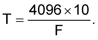

Figure 1’s circuit can generate time delay of seconds to hours without using high value capacitors. This simple, inexpensive circuit is basically an oscillator, divide by 4096 counter and followed by another divide by 10 circuit. The equation below can be used to obtain the time delay, T, in seconds.
Where F is the U1 (555) oscillator frequency in Hz.
