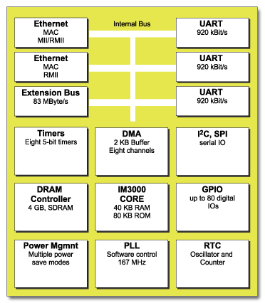

IM3910 Features
  • Deterministic real-time operating system for critical applications
  • Supports C, Java and assembler programming
  • Advanced source level debugging from Java down to assembler
  • Accelerated IEEE 754 Floating Point arithmetic, single and double precision
  • SDRAM interface, 4 GB address range, auto detected configuration
  • Multiplier-Accumulator (8x8 and 32 bits, respectively)
  • General purpose HW timer system
  • Dual channel 10/100Mbit/s Ethernet MAC
  • Eight DMA channels with up to 83 MByte/s sustained total data rate
  • Three UARTs 920 kBit/s
  • I2C/SPI serial interface
  • Software controlled PLL.
Imsys IM3910 Block Diagram
