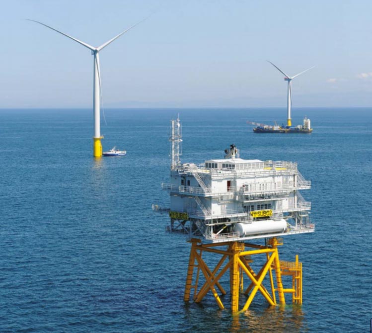

The facility makes use of offshore substations, stepping up the voltage from 34 kV to 132 kV. This is good news for the environment as transmission at higher voltage minimizes losses, and so reduces the need for inefficient lower-voltage transmission to an onshore substation.
