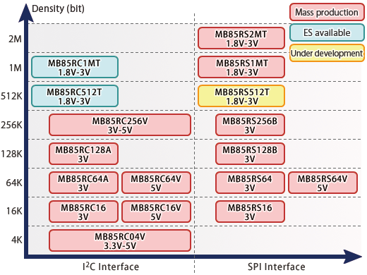

The addition of the MB85RC1MT extends the line of FRAM products with the I2C interface to cover the range from 4 Kbit to 1Mbit, and those with the SPI interface from 16Kbit to 2Mbit (FRAM Product Lineup). These FRAM products are offered in industry-standard 8-pin SOP packages, so they can replace EEPROMs or serial Flash memories, used in applications such as factory-automation, metering, and industrial equipment, without the major change in the PCB design.
