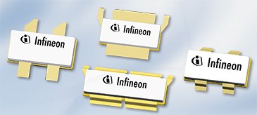

Infineon has launched a new line of 2.6 GHz LDMOS transistors that support LTE applications. The new transistors offer excellent gain, high efficiency and high peak power. They cover a wide range of output powers from 25 W to 280 W and are available with P1dB output power of 25 W, 30 W, 140 W, 200 W and 280 W. The transistors come in open-cavity packages and deliver outstanding reliability and consistency.
Infineon PTFC261402FC
Dual path design PTFC260202FC (10 W+10 W) is ideal for driver applications or symmetric Doherty designs for small cell amplifiers.
PTAC260302FC is a high-efficiency solution for 5 W amplifiers. It has an asymmetric design (10 W + 20 W) that offers 15.5 dB of gain and 45% drain efficiency in a Doherty configuration.
The 140 W PTFC261402FC, the 200 W PTFC262157FH and the 280 W PTFC262808FV provide solutions for 30 W to 80 W cellular amplifiers in a variety of symmetric or asymmetric Doherty combinations.

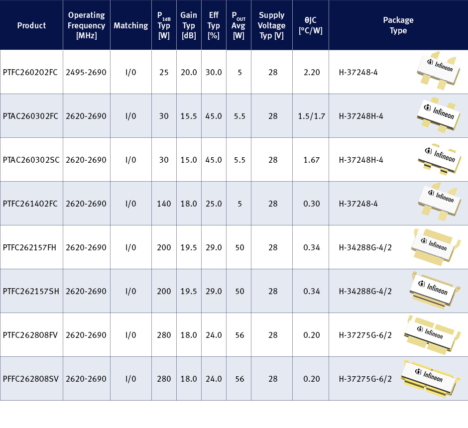

2.6GHz LDMOS transistor product summary

Evaluation boards are available for all transistors. The evaluation board for PTAC260302FC is a Doherty amplifier design. Further information is available in the individual product datasheets, which can be downloaded
