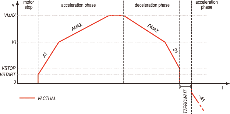

The TMC5130 implements Trinamic’s patented sixPoint™ jolt-minimizing ramp generation profile. This profile utilizes two different settings during both the acceleration and deceleration phases, which minimizes motion ‘jerk’ and delivers smoother motor operation. The sixPoint ramp profile also enables motor torque to be more closely matched to an application’s requirement, producing velocity-optimized maximum acceleration times.
Ramp generator velocity trace showing consequent move in negative direction
Ramp generator velocity trace showing consequent move in negative direction.
