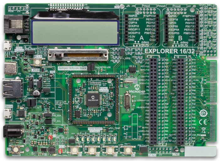

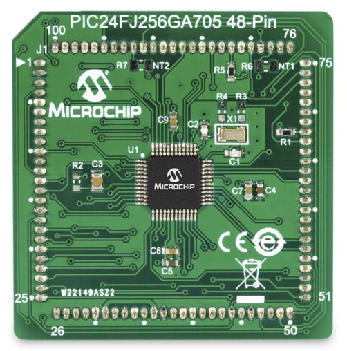

The new PIC24 “GA7” family is supported by the Explorer 16/32 Development Board ecosystem (DM240001-2) as well as the new PIC24FJ256GA705 Plug-In Module (MA240039) which plugs into the Explorer 16/32 Board for easy evaluation and development. Speed up development by leveraging the “GA7” family’s compatibility with Microchip’s established software development platforms including MPLAB® Code Configurator (MCC), MPLAB X IDE and XC16 Compiler.
Explorer 16/32 Development Board (DM240001-2)
Explorer 16/32 Development Board (DM240001-2).

PIC24FJ256GA705 General Purpose PIM (MA240039)
PIC24FJ256GA705 General Purpose PIM (MA240039).
